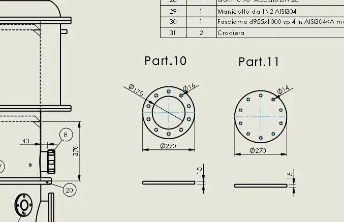

use sw09, I have a design of a set with bubble and separate table of materials. in the same sheet I insert the detail drawings of some parts and I would like to indicate below each the number of the represented part as it is in the distinct. Is that possible?
Thank you and hello to all! !

I have actually explained wrong.. .
place a magician of what I would like to do:
on the left the asse with all its bubble and on the upper right the distinct.
down to the right two details of the axieme. in these two I would like the "title" (part.10 / part.11) to be automatic with the number that particular has in the axieme (and that it was updated accordingly).
Can you do something like that?

I never did. I tried until 2007 but I never found a parametric and valid system to do so.
I used to pass through details codes. the operator had to look at the number of parts in the pile, see the respective code and in every view of particular I went to insert a note that repeated the properties of the details. It would be more direct to the ball, but in the environment together I think you can't. discussions have been made about this and in the forum you should find some solutions even if "artistic"
But if you make a record with a connection to the property that interests you don't get what you want?
in the annotations there is "connection to property" and beyond all you can also hide the arrow that connects the part
I saw in the discussion forum about it, hoping that with 2009 something new came out.. .

the number of position in the separate materials is not a property of the part / together and is not manageable by hand.
someone (among the various workarounds) had proposed to make a custom property to use for the number, but the thing is not manageable at all when you reuse the elements in various assemblies.

It would take a command of the type "insert view of the axieme component" or something like that...

to hope for the implementation of some function you have to make the request through the priprio var, otherwise it is hard. Are you in subscriptions? if you make the request and at least it will be evaluated.
I partially solved the problem using particular display states of the built axieme so that all the details are hidden except those of my interest. Starting from the main view you get a projection view, change the display in the properties and events the move or reduce it. so you can place the bubble to the various details by referring to your main view to which the table is connected. but the table weighs down if you insert many... .
too expensive in terms of time... Among other things, this type of ball in the multibody parts (saldates) works and that is, if you add the views relative to the bodies are palliated correctly.
