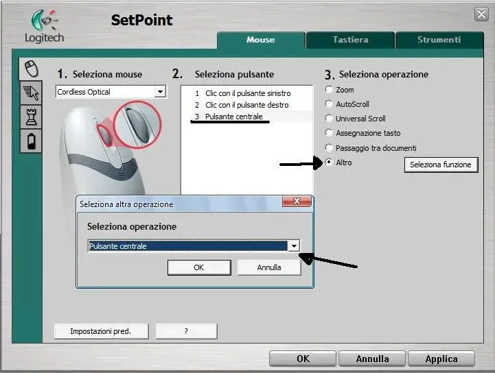

I don't know what you purchased, but try to see if the wheel is configured by the driver as "central pusher", sometimes if the specific drivers (e.g. logitech) change this setting.
I don't know what you purchased, but try to see if the wheel is configured by the driver as a "central pusher", sometimes if the specific drivers (e.g.) change this setting.
logitech... Your answer seems interesting to me... but now I have to find how to restore that setting. . .
An honor to help you... I insert photos of the simple passage!

Thanks, then I try and let you know
if it works it is so simple that one does not think about it::biggrin:
