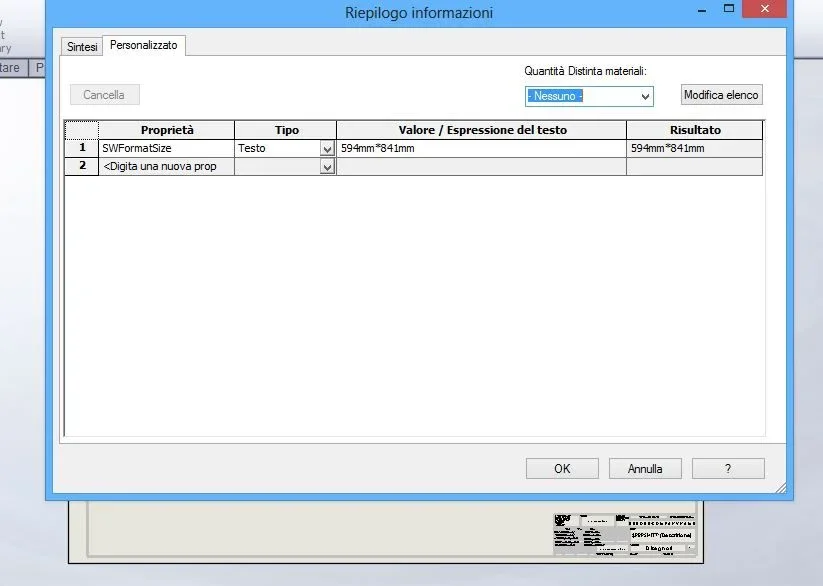

in solidworks I open a slddrw that starts with a certain sldrt, in which variables are stored for the automatic positioning of some blocks as well as to define the format: a1-a2-a3-a4.Variabili_2.webpso, dx key, properties, sheet properties choice window, here I choose another slddrt that obviously contains the same variables but valued differently.Variabili_1.webpperfect layout has changed, but the 2 variables indicated in pictures no.
Why? What am I wrong?
thanks to all in advance
...because those variables there you saved them in the custom properties of the design model that has extension ".drwdot". instead in the sheet properties you change the format of the sheet, which has extension ".slddrt" and that is all another thing.

Hello, thank you for the answer,
but the two variables that need the change do not change the size of the design.
as I wrote in the first post, the layout (format size) is handled correctly at the change of sheet format, only those 2 variables remain constant.
I checked the .drwdot file does not contain any custom properties.
