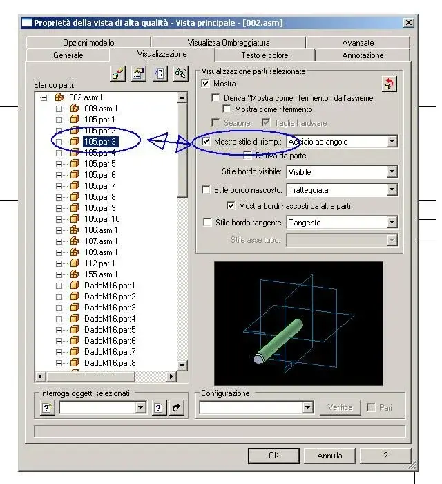

I do not think there is a system to inhibit the display of the sample on the thin parts, you have to do it piece by piece (see attachment).
