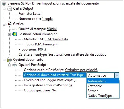

problem display font
many years ago, following a problem, I set the pdf print used by solid edge to always incorporate fonts; for a long time I don't do it anymore and I haven't been reported problems leaving automatic management
