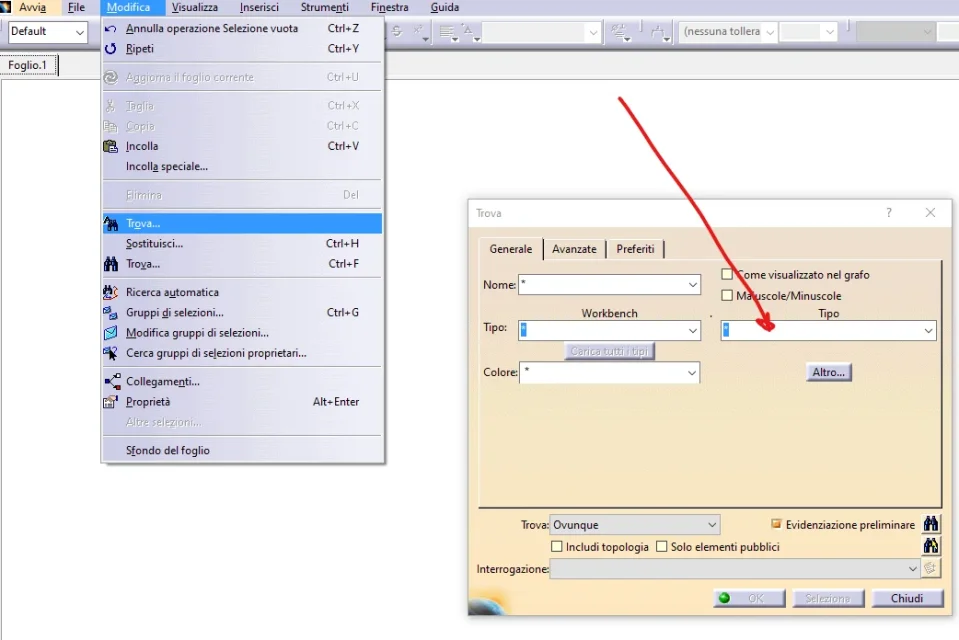

ah bhe.. in this case there are 2 specific commands.
the first is this icon.
If the activity becomes all clear grey except what you have added and has nothing to do with the 3rd example: texts quota annotations etc.
this makes it easier for you to select the items you intend to delete.1652974728802.pngthe second command is the located more versatile
where in the box type select the item you want to delete, a text rather than a line rather than a quota etc.
if you then associate them to phrases or colors the selection is infinite

this makes it easier for you to select the items you intend to delete.View attachment 65622the second command is the located more versatile
