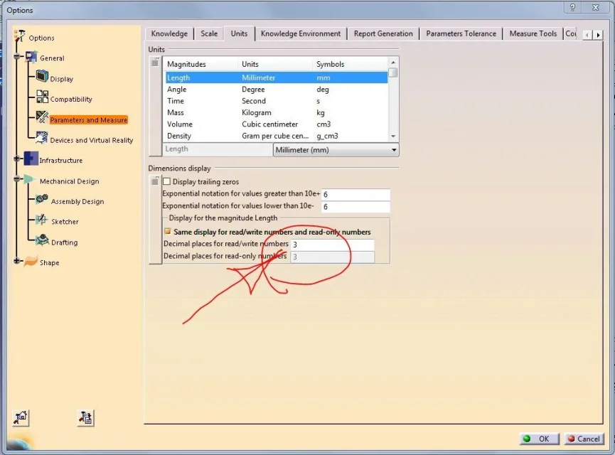

right click on the quota (or if you hold the ctrl key, you can select multiple odds), go to property. in the menu that opens at the first under menu on the left: value, you can define precision.
I don't know if you wanted to know how to set it at first so that all odds are approximated directly to the tenth, in this case I don't know how to help you, maybe it takes a few settings (I never put the problem because I work with the tenths and the cents and then I change them to the need).

instruments<options<parameters and measures
