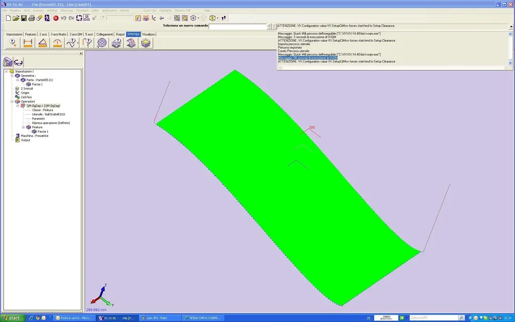

calculate zig zag finish step to 45th step 0.1
time calculation if you can without containment profiles
calculation time with spherical milling d10 mm increment 0.1
and work tolerance 0.01 56 seconds.
thanks to the "gaming" function the tool does not sink into the hole.
I don't have to waste time detecting disputes with relative lifts.
convenient this function if you have to fresare imported mathematicians not perfectly closed, do not kill the pieces

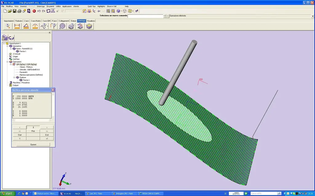

processing for isoparametric 2.5 axis = 22 seconds processing

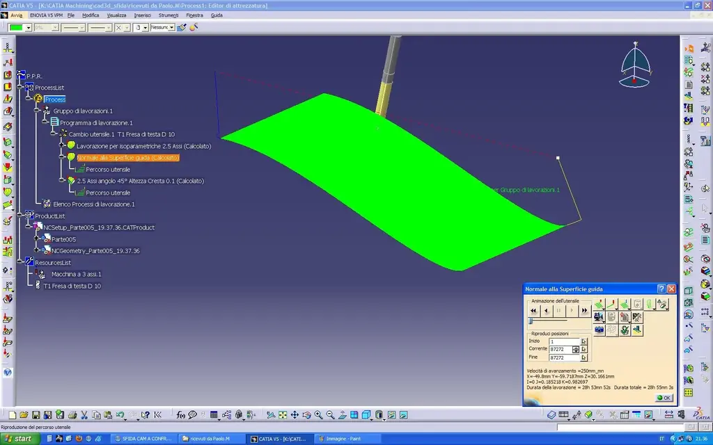

processing for harmonic isoparametrics at surface 4a : 1.32sec processing
normal working on surface 4 axes
