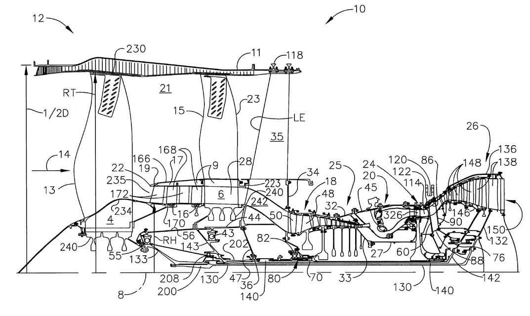

I attach a section of a turbofan (a little particular, it is part of a patent to have counter-rotating trees), it could be a basis to understand how the trees are supported.

3 crown ball bearings??????? ? ? ? ? ?
roller bearings?????? ? ? ? ?

only for the "chronaca", on the compressor side there can be rolling bearings, on the turbine side is difficult, temperatures are prohibitive.
often you prefer to use bearings to "oil fog", bushings, to say it in "soldoni".
But everything depends on application and size.

I apologize, in a hurry I posted the photo of a torbojet and not a turbofan.
I hope I haven't confused the ideas even more, though I've done the debris distinctions, the example is valid for a general approach.
