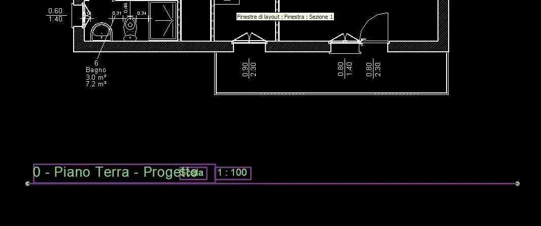

Hello, everyone. is it possible to edit the titles of the views in a press board? in particular I would like to be able to increase the font size and color of the writing.
thanks to all
Okay perfect. I did. I also tried to add a visibility parameter to the scale ratio, so I could choose which views to make the scale appear and in which not, but it does not work. is it not possible to do such a thing?
I managed to create a si/no parameter and associate it with the visibility parameter of the label text. But I can't enter the properties of the title of sight if not from the project browser also happens to others..? :confused:
It's my problem. I set on the label text on the scale a parameter of visibility si/no, but then I can't control its status from the property panel. Does anyone have any suggestions about it?
save the discussion because I have not understood how to get in to change the family of the title of sight, in particular my problem is to move the text scale in the title of sight; considering that I always remain superimposed to the title of sight.
igo image
go to the project browser > families > annotation symbols > view title > right click > change
