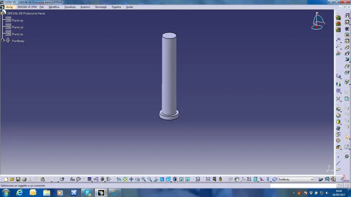

This morning igniting the pc I found the buttons icons changed in the physiognomy.
many icons have been replaced by squares and description as you can see in the two photos .... before and after.
How do I restore?

the mystery is revealed.
igniting today the pc , window asked to reboot the disk, and after 20 minutes of work and correction of errors the pc has magically and the cat icons are back as original!!!! mysteries of faith.
