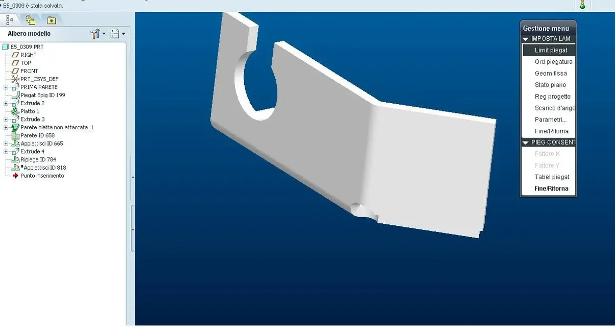

Hello everyone,
I just passed from wf4 to wf5. I kept the same settings, the same config.pro and everything seems to work.
the only thing I can't do anymore is change the value of the k factor from
menu management, set etc. (see attached image).
as you see the items k factor and y factor are off despite there is no turn table active.
I can't even change the values from the "parameters" tab.
for now I add the development by changing the value "dev.l" or imposed the k factor for each bend feature but I would like to return to being able to change the general k factor as I always did, also because I had found the right values to obtain suitable developments to our machines.

Thanks for the answer.
the material is assigned to the default part in the templates.
on wildfire 5.0 the sheetmetal smt_update_bend_allow_info parameter is set to yes.
this means that the information is guided by the material (factor y can be modified by the definition of the material).
set the smt_update_bend_allow_info option on the value no and then the user can change the band table, the y and k factors as in the previous versions.
