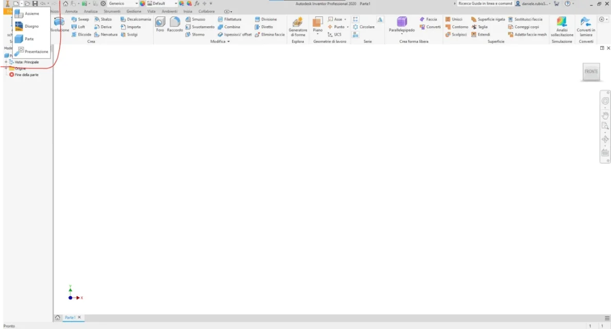

the new icon(inventor) has an arrow at its side, clicking there are files, which I would like to be my models, but I do not find the setting to do so, it proposes its defaults.
someone knows how to set up their own models.

hi I don't know much but I think you can change them from this screen but I'm not 100% sure1.webp
