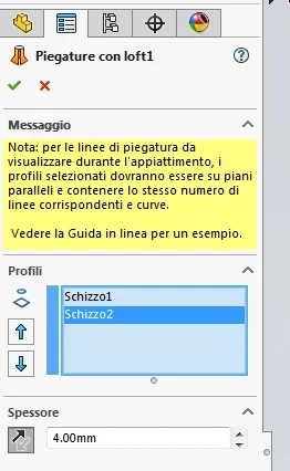

hello to all, in the bending with loft as from attached file, if you open the flat repetition do not export the bending lines. is a sw limit because the plans are not parallel?
Cattura.webpThat's why... plans must be parallel
I did a test very quickly. . .
It seems to me that you have designed too many functions, like planes and sketches, which could be avoided.
if you make the loft straight and then a cut with a tilted plane to me it all works well.

i don't agree with you. the figure to be done is this, if you managed to do it as you say, please post it to me. thank you. Untitled-1.webp
Now I don't have time to remake your file.
I did a test on 2015 redesigning the sunset with random measures.
If you do the bending sketches with loft on two upsides and then cut the result with the angle you need, it should work.
