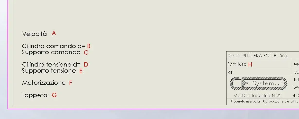

hello to all, we have made some custom cartilages,
in addition to the classic logo+material+data+approved+. . .
We've got some kind of voices.
speed - at
cylinder command - b
command support - c
that we should compile from time to time by changing to the description "a", "b", "c", ..., the current problem is that every time we should "open" the cartilage to edit the various voices, or add texts alongside the words, but every time we should lose time to align/adapt the texts to the words of cartilage. . .
the question is, is there another system smarter and faster?

Sorry you can't use custom properties
there would be various methods to manage these notes. to understand what is most with eburne would need some other info. For example:
Should this information be in the model, in the table or is it indifferent?
Do you have to access us via pdm or can only reside in the cad?
Can it happen to you that you only have to change these notes with the rest of the identical axieme? in theory you could not because at the varying speed the motor group should change.
If I can afford a criticism, I'm not much aesthetically speaking. If I were you I would insert the anchoring point for a general table, I would make a general table template to call to the command and then you have to see how to handle the texts.
for this last info I expect to hear how you have to handle notes and then I think about what I think is best.

I associate myself with the answer of ciarly, if you use custom properties you get the desired result. . .

hi, ciarly and figor71 suggest me to use the properties... In fact I didn't think about it, could it work, i.e. I create them and place them near the description, except all in a cartiglio that I apply to the dis that I want, after which every time I enter into property and enter/modify the property? So you say, right?
even if a little "worky", I try it... I kept thinking "in autocad" and I didn't really think of this solution. . .
there would be various methods.. .
already in fact between the reading of your answer and the drafting of mine, I tried "the tables" (this unknown x mè) and I must say that they solve egregiamente to the problem mentioned, but ending to read you, it seems to me to understand that maybe you could do better, so I keep answering you and see what comes out:tongue:. . .

then, the purpose is to compile a cinematic scheme, i.e. the main data of the machine; such data are surely "present" in the assieme and/or in the pdm, the problem will be to connect them to the table.. .
These info (diameters, power, reduction ratio, type of tape, ...) must appear in the table of the assemblies and serve in the workshop to have the list of essential elements at a glance (in practice an incomplete distinction or the main parts).
How do I access? What do you mean?
If the axieme remains identical, the notes remain identical, if changing gearbox, change the description of the reducer.
Of course, mine was an untreated example, with tabs I see that it already improves a lot in order :
I would make a general table template to call back to the command and then you have to see how to handle the texts.
table made and saved, how do you see how to handle texts? I will now iron the table to please... You mean that?

hi, ciarly and figor71 suggest me to use the properties... In fact I didn't think about it, could it work, i.e. I create them and place them near the description, except all in a cartiglio that I apply to the dis that I want, after which every time I enter into property and enter/modify the property? so you say true
even if a little "worky", I try it... I kept thinking "in autocad" and I didn't really think of this solution... ? ...
Yes, exactly, I do so also because the information I have to insert is not many, and then seen my limited experience with sw2011 is the only way I found. . .
