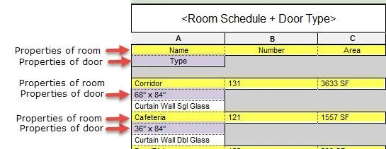

this can be done in revit, of a very limited way, using "embedded schedules". in a local table, you can "put" a table of doors (but, only you can use 1 "embedded schedule"not two or three, as you want.
it would be better to export several tables to the excel and continue the activity there.
or, using dblink from the revit, exporting information to a database to make a relationship of premises with doors, windows, etc., in microsoft access. However, this solution is advanced and needs knowledge of the dblink and use of a database.
this image shows the option of "embedded schedule":
