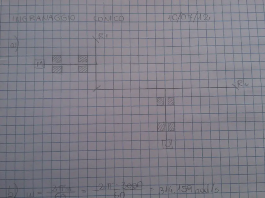

Which bearings are more suitable for the input shaft of a parallel axle reducer composed of a pair of toothed conical wheels?
thanks to anyone who wants to help me.
we see the gearbox pattern, how and where you would like to mount the bearings and then discuss it. . .
the cinematic scheme of the reducer is this:IMG_20140318_085452.webpI would like to mount them where I designed the supports but I don't know which to choose.
I correct the first post: it is an orthogonal and not parallel axes.

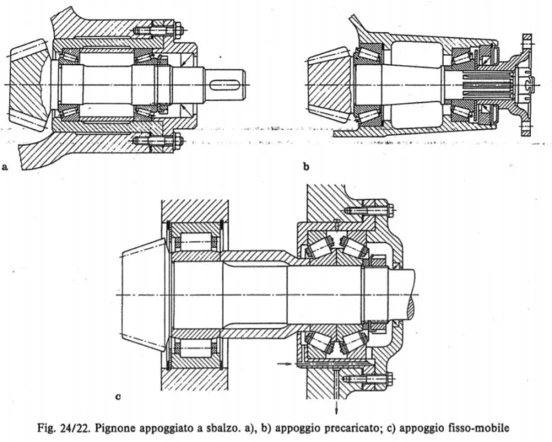

to have a correct analysis of the orthogonal reducer and determine reactions to the bearings advice This is post.
As for the type of bearings, we can mount the input shaft or supported, while the output shaft will have two supports.
