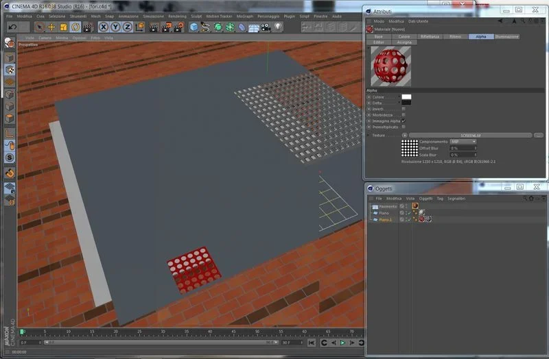

you have to put the pictures in the alpha channel (it is called so also in 3d studio) then apply the material to the surface.1.webp attached two surfaces.
