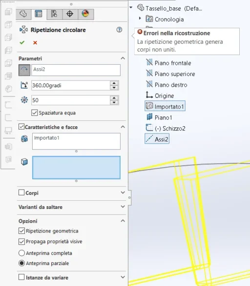

For the first time, I have to shape a part with subtraction of bodies.
I started from a step of a body, doing a vacuum set I managed to place the main plans as I wanted.
at this point save as a file leaves and I build a cylinder around this body.corpo e cilindro.webpat this point I remove the body from the cylinder with the matching functioncilindro.webpMy problem is that of this "negative" on the cylinder I should make a circular repetition, but I did not find a way.
I didn’t find another way to get this negative starting from the body’s stp file otherwise
use face repetition
or repeat the bodies and then do the subterracy
Thank you very much for the claw.
in both cases I get the error message "the repetition generates non-united bodies".
in the late afternoon I will try to document this message
in the second method you do not have to repeat the function that generates the body, but you have to repeat the body; So do the subtraction.
You're not repeating bodies, but the function. under features and faces find the box bodiesfunction repetition implies that the object to be repeated is part of the body on which it is repeated
solved by making linear repetition of the body. I also found a mistake in importing the solid that once solved did not change previous error messages but made the different functions faster.
