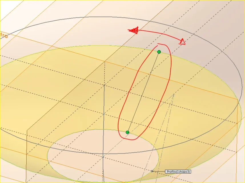

Hello everyone.. By running a simple loft between two circles, I get a line with 2 green balls (see image) that and libara to rotate on the surface of the loft, of course moving it changes the external profile of the loft, are to ask you, how to bind such line? ? ?
generally exploits the top of the sketches. in your case draws sketch points that will ease line alignment, or draw a guideline
Thank you so much vassivon... it works if I do a sketch of driving... only with the points the line continues to be mobile and does not feel the points coma hooking. . .according to you and normal, do I have a problem or a kiss?? ?
with points the line is not blocked as on the edge, but serves as a reference point. If you need to securely manage the loft you need to use the driving sketch

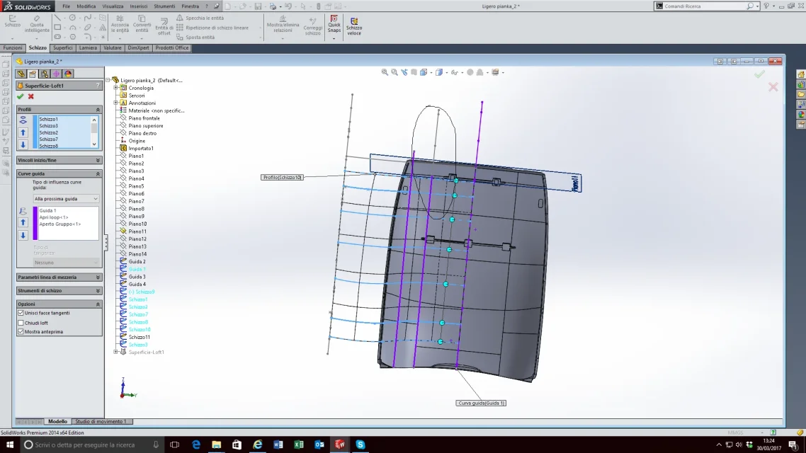

Hello, more doubt...xd!
the guide curves must be passed for the "to join" profiles and up to here there are no problems.
How come, for example, in the selected profile not only does it make me select the open loop but it does not even end with the end of the driving curve?
that it is a problem of construction of the latter?
from a step I got the various sections to join and the curves guide as intersection between various floors and my solid step, but I have the feeling that there is some geometry error that does not make me create the "canonical" guide curves.
As soon as I can attach an exemplifying file.
Hello waglio!
thanks as always.
ps: usually how would you reproduce a geometry like that in figure?? ? ? ?
Is there any technique/consiglio more indicated than another?
