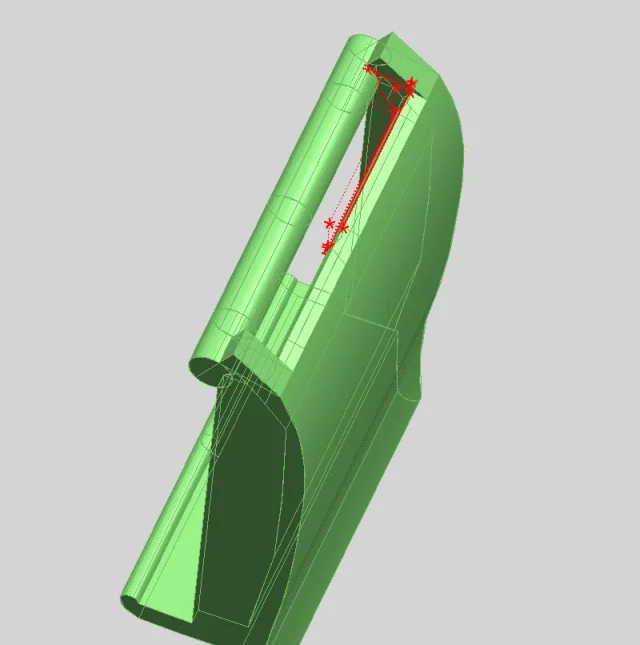

I contact you for a problem that I’m experiencing with exporting to step files. I have a file where there are 11 closed polysurfaces (usually to make sure I use the command “show edges”). the problem arises when I send the file to my recipient using solidworks, which states that some pieces do not see them as bodies/solids but as a set of surfaces. starting from the fact that I assume that “closed polysurfaces” equivalga to say “solid” (correct me if I am mistaken)...I believe that the basic error is precisely in exporting to step files. I wonder if you could help me somehow solve this problem. specific that at the time of export I use the configuration “ap 214 automotivedesign”. I remain waiting for your kind answer.
cordial greetings
ciao @ luca. I was... I looked at the step and turned out to be 1 body on 11 incorrect. This has problems with self-intersecting surfaces as I show you in the image.
the problem is not the step but the basic geometry that has problems.
ok...I am now aware that it is not all file :p cmq test rhino validation tools on all polys, see if they are manifold and with the command "selectbadobjects"

I'm really grateful for your help! Very kind!
