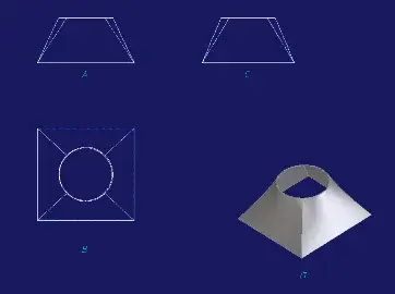

you can also do with the basic module, the important thing is that it is an open profile. development you see only in annotation

You made a solid, then you opened the two faces right?
And you know that.
Now I have to be able to do this reduction and possible! !
succeeding in having development normally! ! !
See you soon.

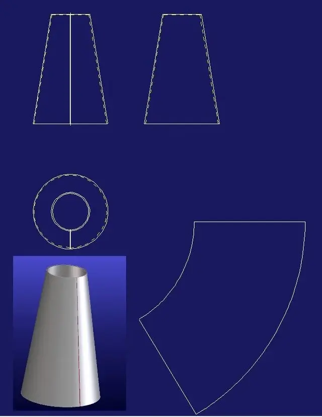

First of all, that is not exactly a cone... when you ask questions so that they are clear! ;-)

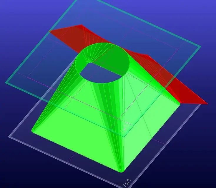

....however I don't have the shet metal, and I don't know if it can develop that connection/tram. between my libraries I have a macro that realizes and develops this type of sheet metal. sin that he does it only with parallel faces choosing between square and rectangular geometry and round. This is a logically all-transportable example in annotation.
p.s. the red part is the development of the half

cmq I also wanted to know about cones, I did not ask unnecessary questions.
Then I'll explain. .
I wanted to know both cones!!!
that of the sunset... Okay!
on the cones you were very clear, although I knew how to make them.... .
But I don't understand how you did the hopper with cocreate.
the hopper made it through a macro.
laminating with plastic deformation surfaces are not developable or manageable by means of sheet metal controls because the psessor of the piece is not constant throughout the piece.
to create the hopper you can use the solid sheet command. draw the full volume of the hopper and then turn it.

sincerely, it surprised me too! that does not make modeling and in particular shett metal, create and develop these types of fittings. I (and others who have this macro) can realize these parts quite quickly thanks to a macro that however is developed externally to modeling, is provided by a company that provides interface and libraries for cocreate. the workshop where work has a specific cad for cuttingplasm, which possesses a myriad of figures that can be created and developed by simply inserting the size and with the help from the figure that from time to time changes according to what fits.
