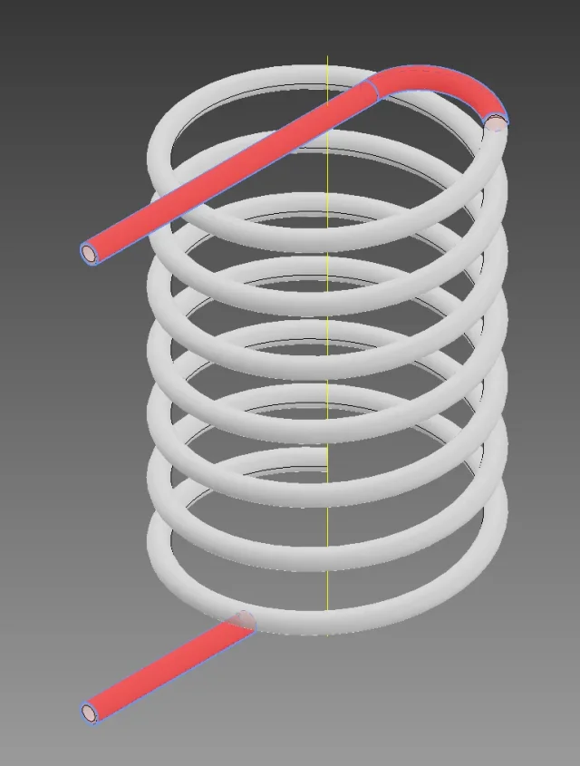

Who could help me in the construction of a casserole?
I can't shut up and let him be linear.
I probably do not use the correct functions.
1713818068813.webpThank you.
I did it by combining a set of sketches to get the continuous path and then a sweep...
You have to work a little on the various parameters to get the shape you want but you do...
I'll attach the file with some invented size...
It's in interference at the last tip, but you gave me an idea.
If the extreme parts build them on a tilted plane I should be able to.
My serpentine has the most compact edges.
Good boy! I didn't know the intersection in the 3d sketch that way.
Wouldn't it be worth doing everything from a single 3d sketch?
I think it's possible.
I had to do it fast and the first solution I found was good. I will also try with 3d sketch and assess which one is the best.
