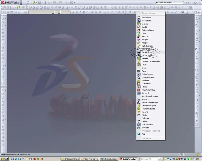

.... but where is the "line format" menu?
I can't find him...
... if you want to change the color of the sketch while tracking, see image.

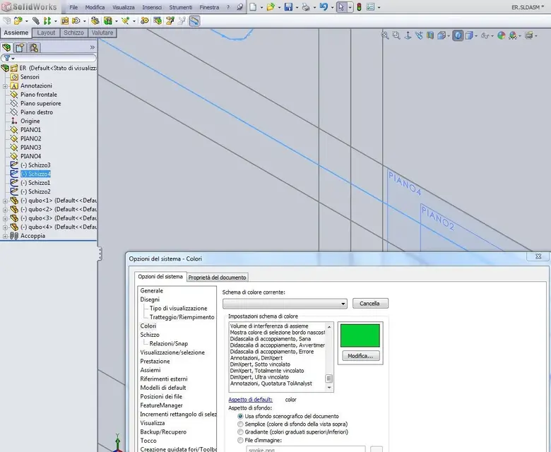

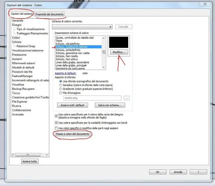

but so you change them all, from system.
instead directly on the side, right clik on the sketch (on screen or in the aber) and choose color sketch. you can assign them all different and in the asses you see them so modified.. the "original" sketch remains in the color of first draft.
