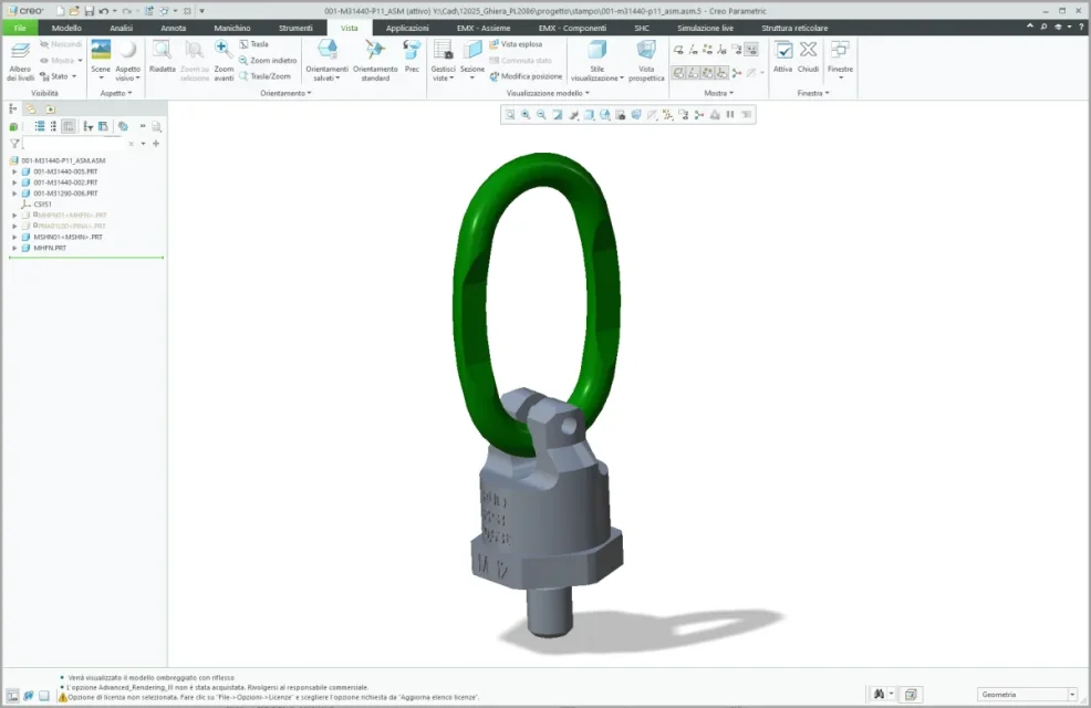

Good evening. with creo I can't get this steel effect as this firm does and I can't find anything that you make me; can you give me some suggestions? I have prts, asms but are gray and just, the other colors do not approach similar reflections. . .
Of course but with creo can you? Is there a library or something to do that you know?

but don't you have the "render studio" item on the instrument menu?
I tried on the fly and something you can do
creo4.webpwill depend on the license but I knew that all licenses "creo design ..." had such a possibility
Wow, man! I got it, the one with the blue teapot icon but I click and nothing starts! !
Yes, he says this;
Unselected license option. click "file->options->licences" and choose the option requested by "upon license list".
I didn't study too.
this below I did it with display style: shade with reflections
Yes, I tried with the one supplied in several ways but effects like this can not get unfortunately. I think we have to spend 1000 and spend Euros a year and take it as planned.
