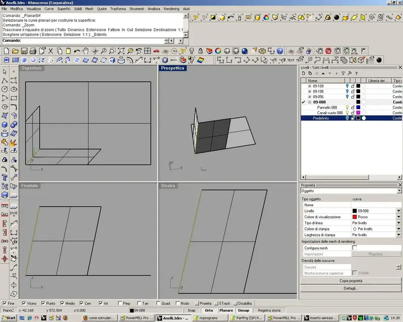

I have a sloping curve and I would like to extrude it in such a way that the faces are orthogonal to the work plane. I hope to have been clear.
thanks to all
I try to relay other elements with a little time I insert an image. I'm new to the program. . cmq..praticamenta I have to realize a tilted flat roof..I would like the 4 faces of solid contour (tect) to be perpendicular to the plan of rhinoceros and not to the tilted plane. . when using the command extrude the reference plane becomes that of the inclined curve. I hope I've explained better..thanks again
but excuse me genuine, even if you are perpendicular to the tilted floor of the roof, can't you turn them later?
I managed to solve by changing the direction of extrusion of the solid after drawing a line in the direction I wanted.. I think it is a good method.. thanks to all
both a curve and a surface when extruded maintain the perpendicularity of the building plan on which they were created.
to extrude along a different direction it is possible to use the direction option inside the extrusion command (but it is not very clear as setting) or... .
use the _extrudecrvalongcrv command to create a solid extruded from a curve along the direction given by another curve.
or the _extrudesrfalongcrv command to do the same thing, but from a superfice.
see image attached :smile:
