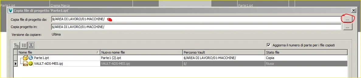

are to ask you a delucidation on the project copy command in the basic vault, the question and addressed to all those who use it.
when they are vault to copy a file the command is called "project file copy", when selecting the command exits a window that makes you
choose where you want to copy the new file, but likewise makes you choose where to copy the file.
place an image, to clarify better what I mean.
Can someone tell me what it takes and how it is used inside the vault? ? ?
Thank you very much
I often use it, for example to copy a set with all its components.
If, for example, you have to do two assemblies with some different pieces with that command you manage it very well.
in the window choose which files to reuse, which copy them rename, which exclude etc.
to copy table and part or together connected with new name and remain connected or to copy together with all its parts and decide which to recover and which to create new names.
