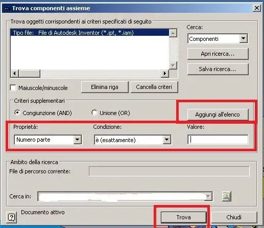

I have a problem I've never been able to solve.
in a group, .iam, when assembly consists of many components, how do I identify a specific component?
I tried with "too component" but nothing! I can't!
Thank you so much in advance!
if you see it at video but do not find it in the browser -> dx mouse on the part -> find it in the browser
if you find it in the browser but do not see it video -> dx mouse on the part -> find it in the window
If you don't see it here or there, you have to use "find component", it's not very intuitive but it works.
with "find component" , type the reference code, but does not find it, does not highlight it!
:confused:
Thank you so much mauro!
Your help is great!
I didn't operate the controls properly! :wink:
solved!
small trick, open separate components together and resize it so you can see your set too, look for the part in the separate list of components and you will see that it will remain highlighted also in the axieme; you can also always open from separate components.
