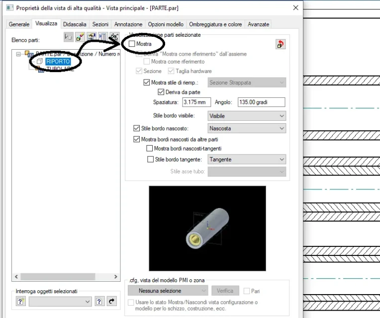

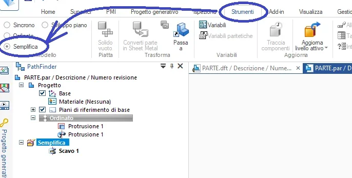

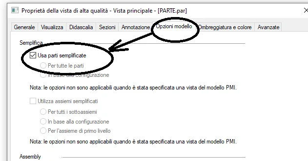

good afternoon, how do you then recall the raw piece in one view and worked in another?
being formally a set can be placed on the table showing or hiding the various "elements" that make up it, or recalling the various visualization configurations that make up it, and showing or hiding the features of assemblies.
your question makes me understand that you do not know the draft environment well, at least as far as the table of assemblies is concerned; I suggest you do some exercises on this.
