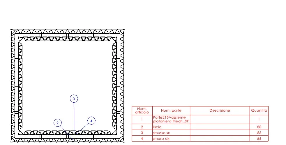

in the file that I attached there is a set within which a component, (the one with extruded triangular shape) has three configurations: a "lixe", one with a right bevel and one with a left bevel.
I repeated and mirrored this component several times by setting the configurations I needed.
Now, when I go to generate separate materials, the counting of the elements is not correct.
I can't understand why.
Thanks for the answer. but according to you how does the quantity column not calculate the correct sum? I took a look at the opzine indicated in the guide but... it didn't change much.

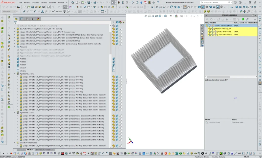

I can't look at the axieme. the image is fine to itself because without explanations, you have put three bubbles of which only one valid. if you want to view configurations as if they were different parts you must use the "configurations listed as separate entries with individual article numbers". probably who will open your set will understand the error
I checked and in fact they were excluded from distinct materials.
so I clicked right over the components and enabled "include in separate materials". now the count is correct. thanks again for the help pose63
