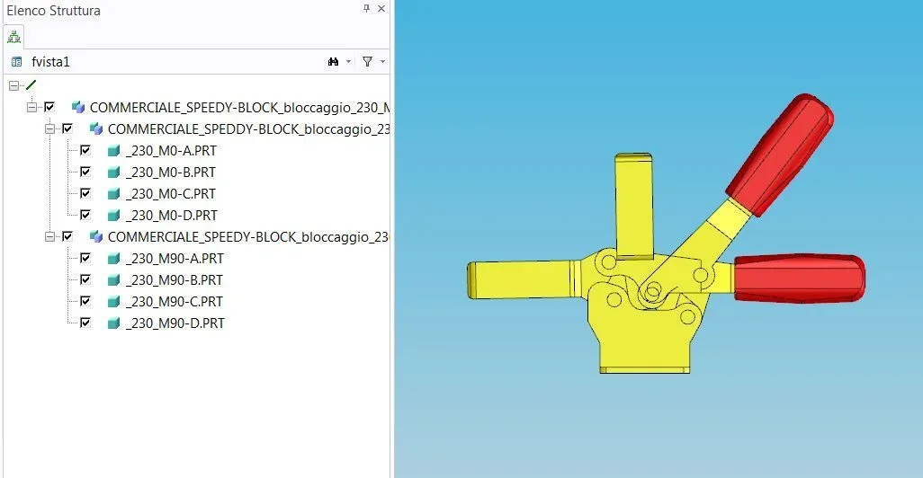

now the customer's library contains items like thisBloccaggio_libreria.webpas you see it is composed of a group that contains 2 other groups, one for locking closed and one for the open position.
overlapping double parts and, to see the same open, you have to go look for group by group and turn off that in closed configuration.

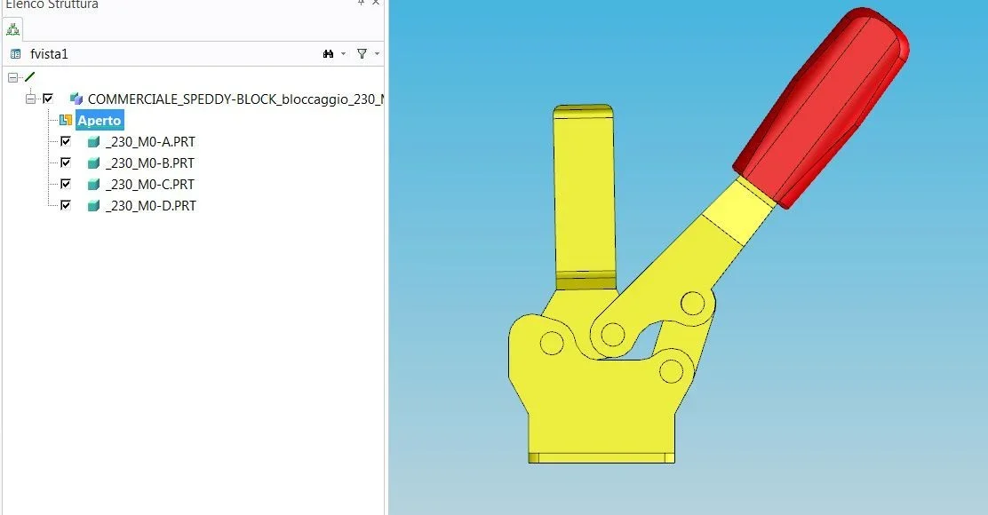

now I have created the same locking in this wayBloccaggio chiuso.webpwith a simple configuration I represent it openBloccaggio aperto.webpI go to insert it into a project where I have, for example, a lever that can open and is stopped by the locking.
