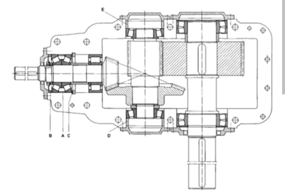

conical pinions and conical wheels require the use of conical bearings (or oblique) as it is necessary to apply a preload to obtain the registration for a correct ingration, in addition to the fact that they must support axial thrusts determined by the particular type of ingration.

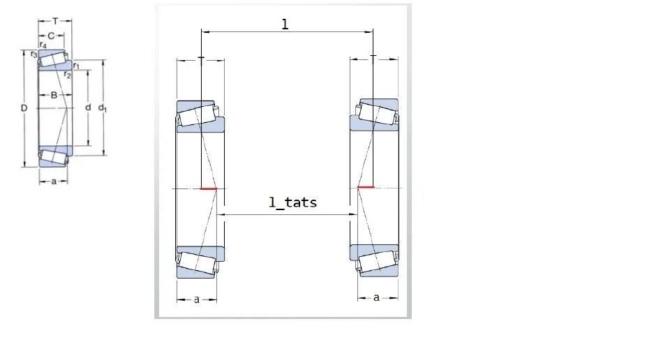

can you represent the bearing with quotas t and to better understand what you mean?

I think I've given too much unnecessary information. . I just wanted to know if the conical/adjusted bearings for conical wheels are always used, or if you can also use a bearing arrangement for the bond side and for the free side.
in the case of bearings for the constraint side and for the free side the sizing is easier.
in the case of regulated bearings changes a bit the distance between the bearings. . .

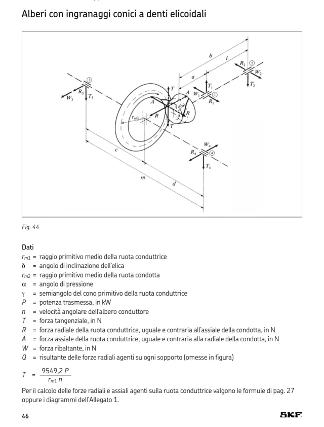

skf training notebook says that oblique or similar contact bearings have the axial shift of the reaction application point Screenshot_20240712_225945_OneDrive.webpbut certainly give as classical calculation scheme the followingScreenshot_20240712_230023_OneDrive.webpto be solved with the following formulasScreenshot_20240712_230053_OneDrive.webpThis means that if you consider first approximation a=0 calculations a first interasse that will then be recalculated... obviously do it for security.

other bearing arrangement is this below. as you can see you can adopt different types of bearings depending on the size of loads, shocks and vibrations, more or less high forces depending on the angles of the cones.1720967478066.webp
