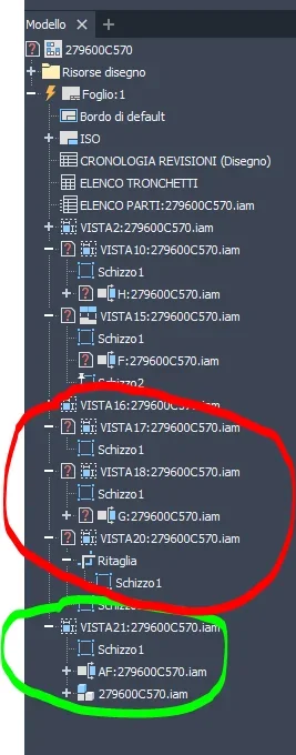

Usually when a set does not find a connection with the solve function, go to reconnect the files to the axieme and everything comes back in table order included.
In this case, instead, with the button resolves on together I reconnected the missing part and was affixed, but some views of the table disconnected them from the axieme and I do not know how to make them reconnect.
Do you know any function suitable for purpose?
The green views have its set below, while the red circles have not lost the connection with the axieme.

the first problem starts from view 10
is it an independent view or derived from others?
can you attach the whole table so you can understand how the views are made?
is it possible that the component to which the view refers has been renamed and or moved?

magically the axieme reconnected to the views losing some odds and some detail views.
is not a 100% valid solution, but recover a good 90% of the work.
