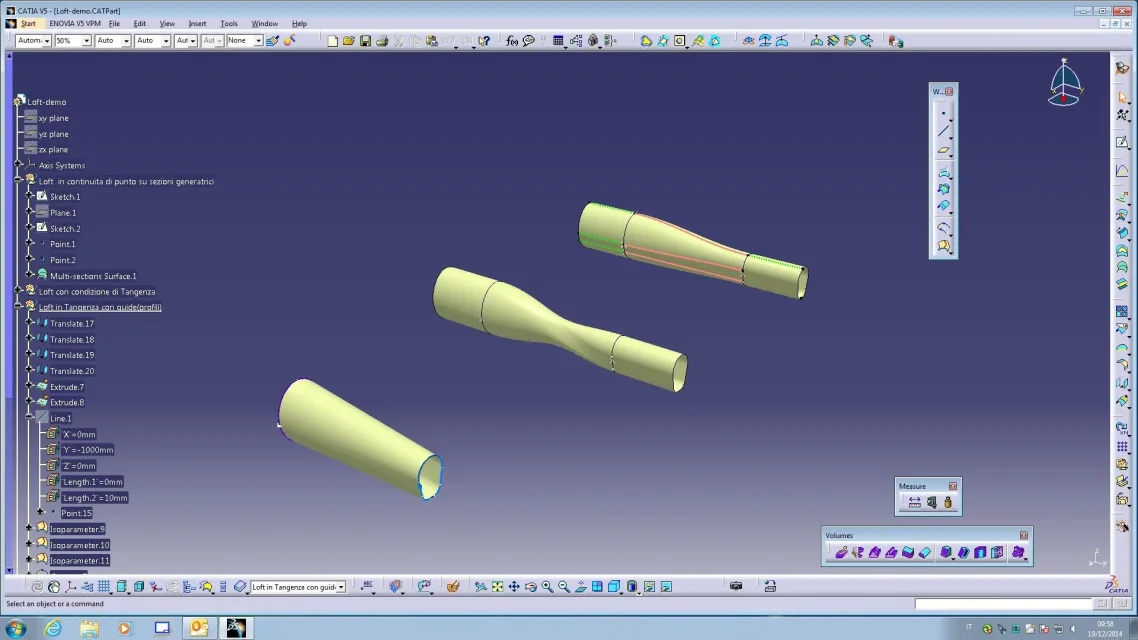

in the attached file, you will find different
solutions for what you ask, and I believe
you will find the answers
to your problem -
I just want to focus your attention
in the closing points of your profiles,
very important in the case of coupling
of different sections,
and in the creation of possible guides
that will allow you to get solutions
different.
always refer to help online
for creating multi-section surfing(loft)
greetings
