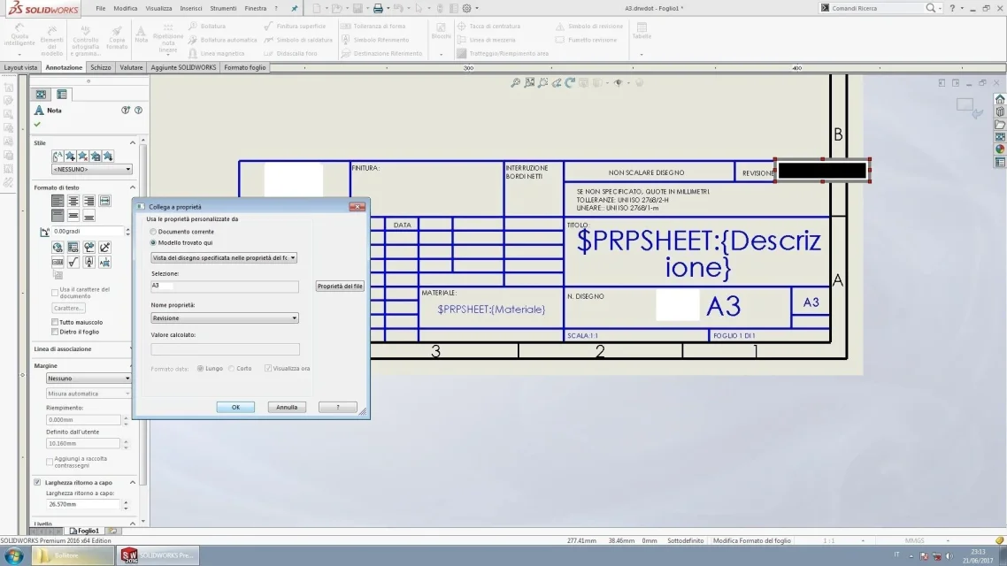

Good evening,
I kindly ask for help because I am creating a new cartilage. I have problems with connecting to property. or some sw notes when selected the property I was interested in from "owner connection" in the note automatically inserted the $prpsheet string:{description}. while now if I refer to the same procedure no longer inserts the string with the command $rprsheet:(the name of the ownership} but only " nomeproprieta.
Can you help me? Thank you.
I also attach photos of the procedure and what happens.

Have you tried using the current document item? what you have selected is linked to a view which of its is wrong because in the cartiglio you must have properties related to the part inserted.
Of course it would also be enough to insert the $rprsheet in handle... if one has good memory and practice could fill the cartilage by writing the strings manually instead of using the links of the curtain
with the current document item does not take the property data I enter from the 3d.
If I put $prpsheet:{namefunction} it is as if I took the function as a simple text so much it is that when I come out from the model modification the text remains while in the other boxes where there is the function inserted by sw disappears the text.
