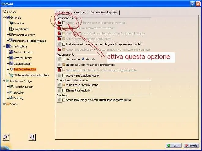

I asked you how ever I built a tubular assembly and then or created a sub-assemble with a linear guide.I come to the dungue the holes of the tubular I made them concise with the punctures of the linear joint using the concise bond, but if now I move the linear guide the holes do not move together. ? Thank you in advance? ? :confused:
hi, so if you projected in the sketch the guideline by isolating it then happens as you say, if you do not isolate the line the drill should move in virtu of the changes. you better tie the hole coincidences directly to the finished geometry of the piece.if you have the chance you send me a photo of the problem and I try to be clearer.
:smile: thank you guliver, but did I not understand what you intend to isolate it?? ? However not to make confusion I send you a folder that inside has a boarding, name amb.banco,maybe you take a look and then I explain what I did.thanks
activate the option indicated in the figure and you will see that the hole follows the shift of the guide
thanks guys all right, you have solved me one of the thousand problems:wink:,or activated the option indicated by ferrezio everything ok:finger:,souovo thanks:smile:ciao
