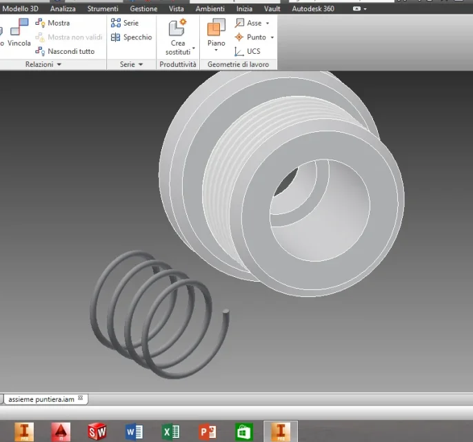

Hi, guys.
I need help to bind the spring inside the hole of the other piece
thank you and good Sunday to all
save abdessamad97, it is sufficent to impose a bond of joint type coincidence between the axes of the spring and the hole on the bushing (which corresponds to the axis of the bushing itself )
Afterwards you have to bind the grinding plan on the bushing with a perpendicular plan to the axis of the spring and passing through the starting point of the propeller that generated it, possibly act on the orientation to get the right one.
