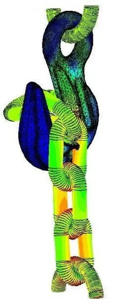

Thank you. with the Straus7 I took the theoretical manual that illustrated the tricks to improve convergence. with promechanica and neinastran is there no manual? However I tell you that the promechanic postprocessor wf 5.0 doesn't seem much changed from wf 4.0, indeed for nothing. I think I'll make a demo on our real case from some innastran dealer. a photo illustrates the tension study of a hook coupled with the chain (we had to decrease the tension peak at a point because we did not exceed the fatigue tests) (in rhinestone you have to insert variable stiffness links to simulate contact), another photo one of our products. the elaboration of the results in the post processor for us is fundamental. cmq between the purchase of proes, of the new management this year we have already spent a package in software (fundamental, for charity).

ps: I know that hook. Consider that such a problem requires hours and hours of calculation of "mostruous" workstations (regardless of the solutor) :smile:
Well, obviously the chain ring is schematized with beam elements...and then cmq I positioned the hook in the "presumption" configuration of balance (almost static simulation). the deformations are minimal and then we were interested in a comparative result (among different geometric features) rather than the absolute correct values. Of course, that image is used for mercenary purposes. :-)
