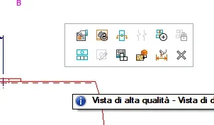

Davimont Guest Mar 27, 2024 #1 habits are hard to die and this menu for now is giving me only problems in the draft environment. Is it possible to turn it off? then maybe I realize that it comes in handy but for now I click in randomly and do only damage
Be_on_edge Guest Mar 28, 2024 #2 in the options - driving elements, remove the check from "show toolbar context" then you will have to do everything with the right button
