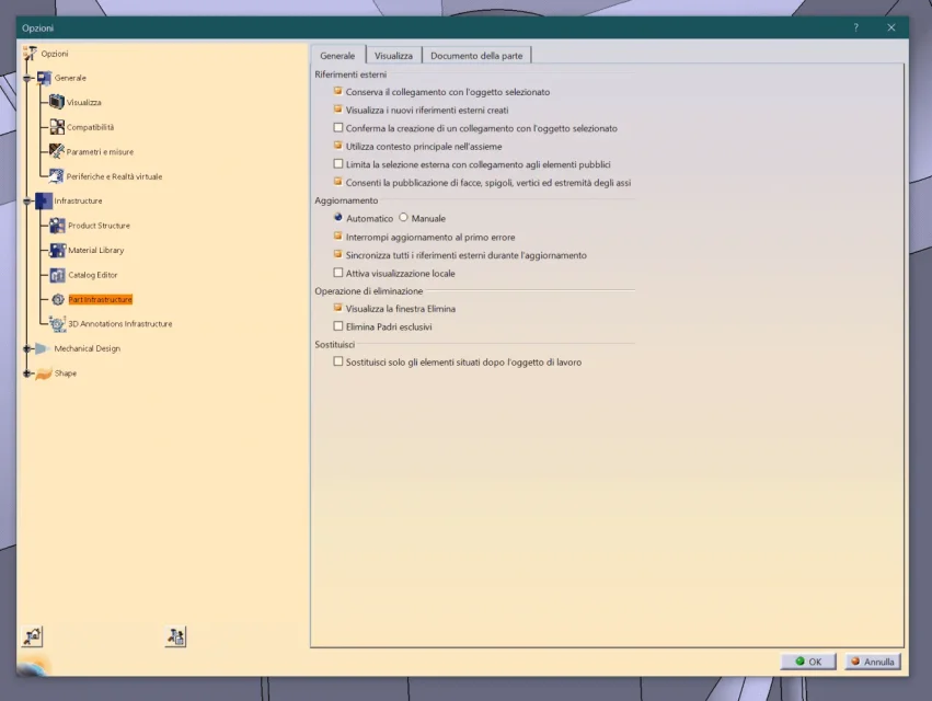

I found the solution in an old discussion. However it is a check that was missing in the options section, part infrastructure. more precisely the item "holds the connection with the selected object".

when migroes from one version to one more recent it is a good habit to make a copy of the catsettings and then reuse them in the new version.
even better document all the changed settings and below in the new version manually relocate them.
we do so
It is recommended.
with the copy, if you have old or corrupt files, take them back.
I would.
You do it once for every new version.
I document in a word file each edited setting.
Sometimes it happens that a set of an old version does not work well in the new.
before you find yourself why, isolate the problem by excluding this risk?
