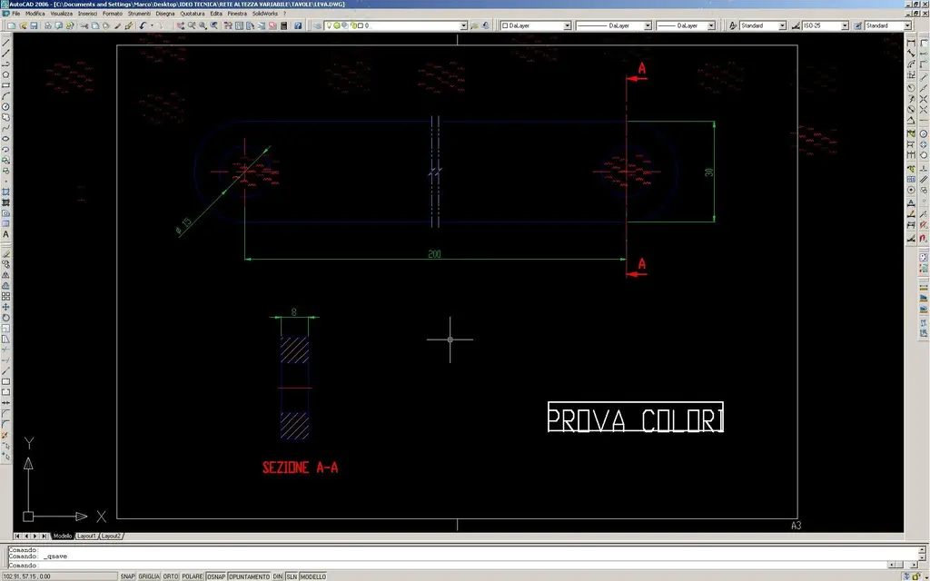

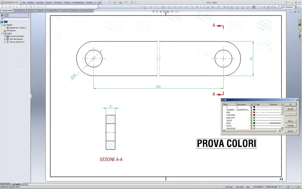

even without using mapping, if you have colored views (I never do it, always all black:smile:) and you want to bring back the same colors in dwg just create in swx the levels with the different colors (and wanting styles and line thicknesses) and to these asses the various entities. in autocad is imported everything with the layers you had made in swx respecting the colors:PROVA COLORI SLDDRW.webp PROVA COLORI DWG.webpI repeat, without using mapping.
