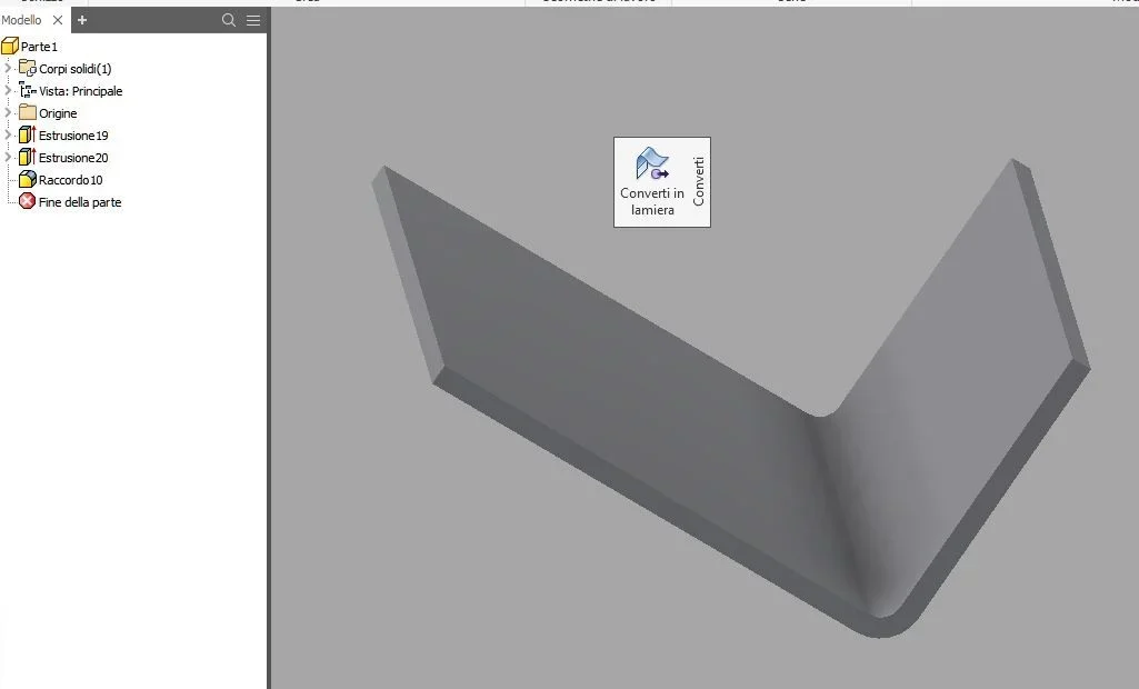

First of all, thank you for the answer, so you're telling me that if I want to make the sound edge sheets recognize to inventor, just open them one by one with the sheet module. we will try, also because now I pass a set that contains several files, some are other parts are sheet metal, but in the inventor conversion opens everything as body feature parts, so for each sheet I have to pass the version "developed" to be able to make the table. but if you tell me that by opening the individual plates you recognize them as such, we could save a passage. Thank you.
inventor does not recognize a part as mechanics/carpentry or sheet metal if not because you declare it such.
in conversion the part of itself becomes a solid and nothing else.

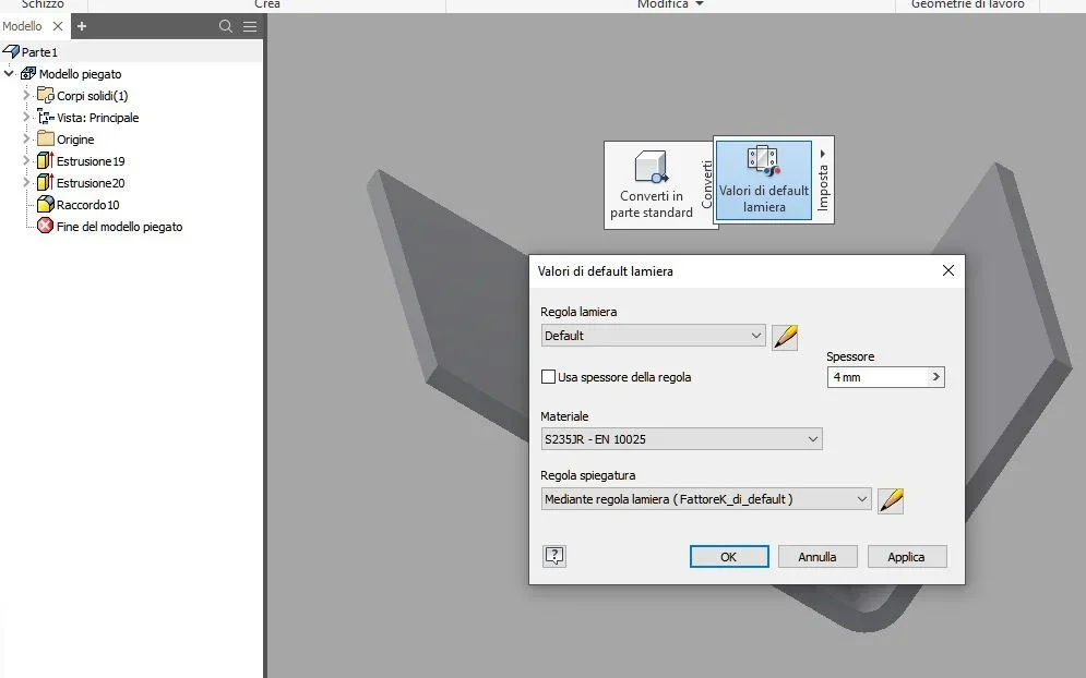

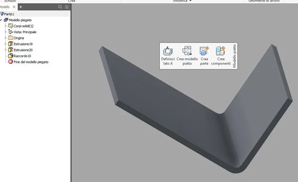

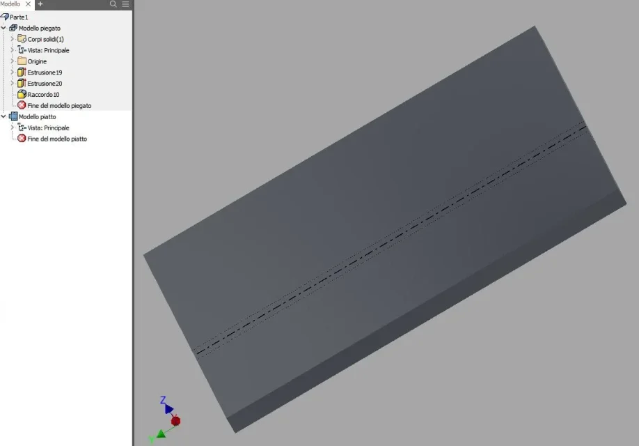

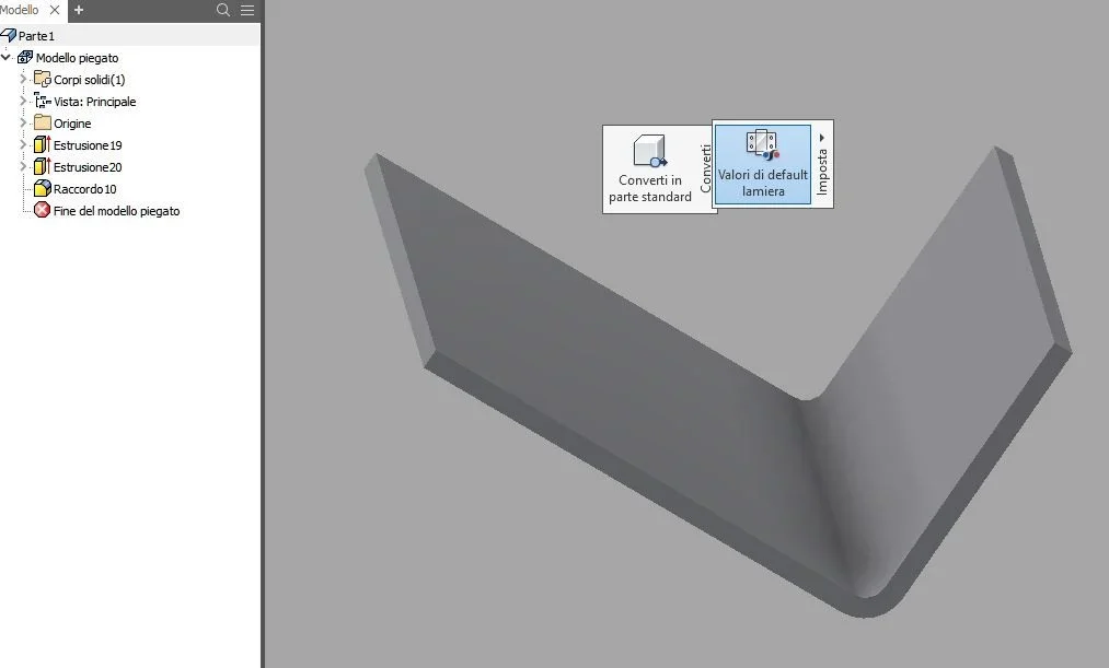

there is no opening with the sheet module, there is an opening of the ipt model, then transform it into sheet metal.
you have to say that that solid is a thick x sheet, make inventor create the open sheet and then put on the table.
Particolare solido piegato.webpif I press the button " convert to sheet " and then " default sheet values "Particolare trasformato in lamiera.webpthe solid part turns into sheet metal and opens the window where to indicate the thicknessSet spessore lamiera.webpCrea modello piatto.webpModello piatto.webp
