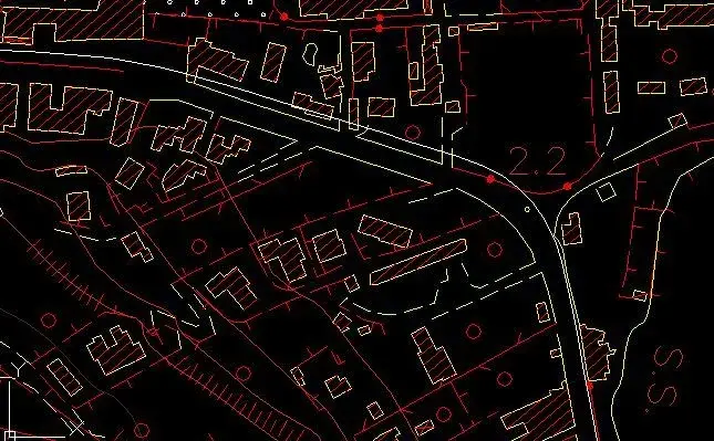

I managed by autocad map to turn the coordinates a bit helping me with a juda found online a bit through a tristan guide dated December 2012. :
especially for the trajectory.dwg file I used the reference system ll84. for an aerophotogrammetric to 10000 of the province of Messina instead I adopted italy-e-rome (with italy-e I had a scaffolding). the two files seem to overlap even if not perfectly (vertical cost of 7 max 8 meters). Do you think it might have been wrong? or is it still normal to have a certain deviation because of the fact of having operated transformation of coordinates? I attach an image to you.
at this point, if you want the coordinates tabled in excel it would be possible to extract them from the dwg?
@studio.avarino. thank you but unfortunately I couldn't set the type of coordinates to which I was interested: does not refer to lat and long but to lamda and fi..

On the other hand, about the fact that the two dwgs aren't perfectly overlapping, am I wrong or is the problem due to conversion?
