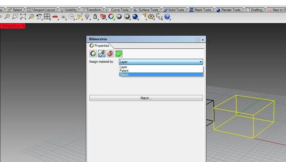

Good morning,
The next problem I think is very trivial but I didn't find a solution.
1 I copied an object
2 I applied an image as a texture by taking it from the pc folder and dragging it to the object
3 then I copied the object because I needed so many equal objects but with different textures
the problem is that if I go to change the texture of one of the copied objects, I change all the others as if they were connected. I would like to know what is the command to have various equal objects with different textures.
Good morning,
when a texture is applied to the level, all the objects contained in it have the same texture.
If the texture is applied to the object, then you will get what you are looking for.
see image attached
