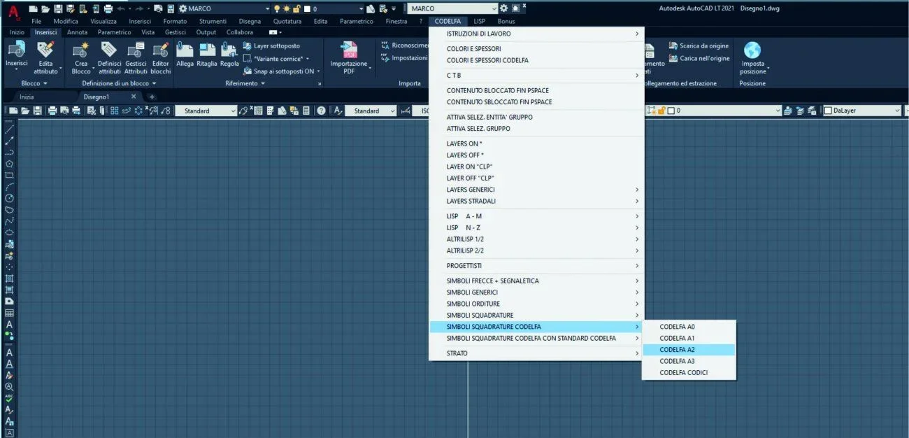

good morning to all, I passed from autocad map 3d 2015 to autocad lt 2021.
how much personal menu loading no longer reads them....can you help me? Thank you.
Maybe if you were more specific you can try... what does that mean "don't read them anymore"?
"does not read them anymore"in the sense that by clicking on the command set in the drop-down menu, it does not run it anymore.
Thanks again and available for any further clarification on this.
Don't you run it and...? What does he write at the prompt? is it not that by chance you are trying to launch map commands on lt?
from the prompt writes: command unknown "command name". press f1 for the guide.
but are customised commands? Maybe made in lisp? look that lt is not programmable then all that of custom (lisp, vba, .net...) that worked in map, in lt does not work
