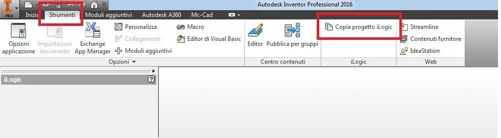

if I don't remember badly .. the command is copy project ilogic
the case I had questioned refers to existing files to which I have to add ilogics to extract properties.
the command you use in case you need to copy files. in my case they already exist.
thank you anyway for your matteo answer
Maybe the logical + thing is to realize external ilogics
I personally realize them only so, so be launched from any file
then managing "autorun" if you want you can automatically launch them to open files, save or change iproperties or other
