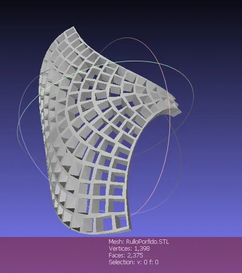

I realized by inserting the leaks on the negative of the porphyry that I am using as a test, and I introduced a corrective that reads the basic model in its three dimensions.
better than the explanation I think it is worth the image.
But now I have to adjust the length of the base model again if you want to get a perfect cilindo with the complete rotation.
As I wrote, it's not parametric for now, so I have to find the exact length in reverse engineering.
However the new code is now exact, i.e., I read a model not only two-dimensional.

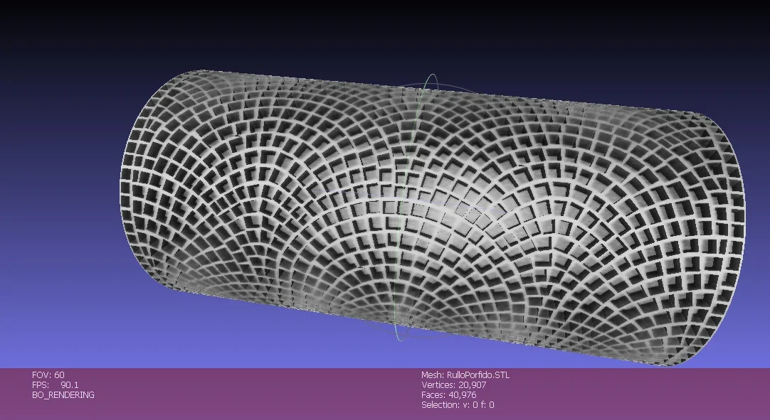

Clipboard01.webpCome back. end of the story, you do not need to update the last list because it passed every test.
in case someone wanted to try it or use it I provide the definitive indications.
1) the ribbon to wrap, to form the exact drum, must be 2pi long on the x axis. a pleasure y e z. the whole place in the positive dial (I place the tape from 0.0.0).
2) I do not make the parameter code because it is useless, the resulting cylinder will be scalable already of its own.
3) the engravings on the drum are to be detected with positive z on the tape (it wraps upwards).
4) before launching the command it is appropriate to create a new layer for the cylinder and to make it current, to release between them tape and roller, and to be able to manipulate them without difficulty, having both origin 0.0.0 will be partially overlapped.
5) the code only supports 3dface entities. others will be ignored.

the "reverse" that I posted a long time ago, to create continuous stamps in cylinder, it returned useful to me while having "stressed", and without problems.
I had created a snowy pint with overlapping waffles, but it was too regular, and besides, too difficult to select the branches one by one to stretch them down without messing up everything.
I thought of trying my reverse engineering code of stamp without too much confidence. ergo:
maximum radius to 2.00.
center of pine cone base placed at 0.0.0
stretched from 0.0.0 with growth y (remember, as a rolled carpet stretched on the ground)
applied the defun mprint (activating another layer, otherwise the new shape is intertwined with the original and it is uncomfortable to treat it), I found everything unrolled on the floor, like a lawn from which the branches start vertically (but with negative z, I remember, it is for stamps).
easy then stretch them one by one.
and when I'm done, I've "returned" with hprint.
and here's the result.
Remember, the radius goes to 2 because the algorithm uses the pi without parameterization.
the finished work then you can reproportionate as you want.
Good Christmas for a long time!
