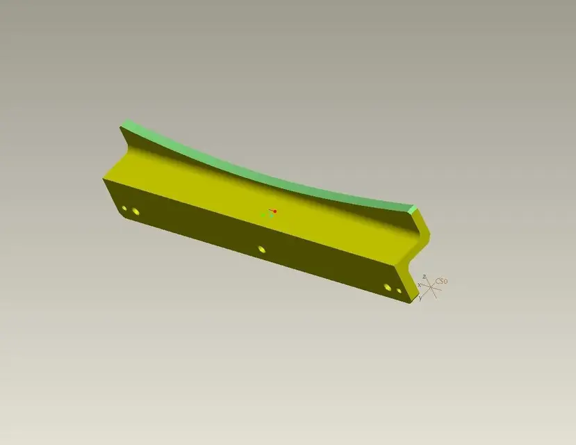

Hello everyone,
I have detail in photo in .jgs format,
the green color surface I have to widen it of 10 mm being a surface how do I copy its geometry?
thank you for everything
Should you only widen the surface or should you thicken the sheet?
However, given the simplicity of the piece you should remake it in pro-e. You can put us up to 10 minutes.
Bye.
I can also thicken the sheet in order to widen that surface. .
I do not know how to draw it as it is above and a surface:(
attach the file I'll take a look at and tell me what version of pro-e you're working with.
Bye.
unfortunately I have uninstalled the wildfire 3 already for a long time. do so in wildfire 4 and exported in neutral (.neu).
Take a look and tell me if you're okay.
Bye.
