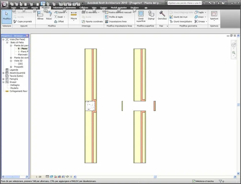

I would like to correct a thermal bridge between wall and pillar, attach images:
1 here is a first problem, the wall crosses the structural pillar;
2 cut a stretch of wall and wrap the pillar with a (muro) insulation;
3 extending the wall to the pillar;
4 "and voilà" the result.

If I understood correctly I should make two walls that combine, one with isolation and one without. )
the fact is that I would like to use a composite block (of a firm note) which is composed of all the necessary stratigraphy in a single stroke.
I attach a catalog image.
If I have understood well with revit it is not possible to create only type of wall whose internal stratigraphies behave as in the particular attachment? i.e. the internal one slammed against the pillar, the insulation is fitting (in some way) with the insulation around the pillar, the stretch layer stops against the isolation and the plaster continues?
Thank you

Honestly, I'm a little tired of doing this.
the start seems ok (but with the settings attached).
when I close.......disastro.
Obviously something is not clear to me.
Mar
for the side walls to the pillar, select the joint button (pallino blù) and clikka on : prevent joint
