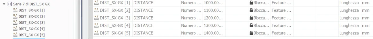

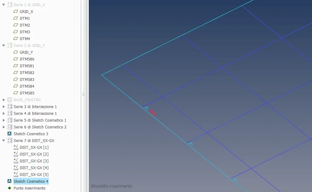

good morning to all, I am creating a cosmetic of a grilled on a floor, which identifies me a reticle of lines at constant pace, all is parametric because the position of the grilled varies as well as the size. Now I have to insert cosmetic sketches that for each line give me the value of the measurement relative to the distance of the line regarding the reference coordinate system. to have beyond the grid lines also the indication of the size of each of them from the set reference. I have therefore made a series of measuring features that give me the values, and lean on a series of previously created plans, which I used to draw the grid. then I inserted in the cosmetic sketch the parameter relative to the first measuring feature of the series, so as to create the text for the first line. Now I can't make sure that the series that I then go to create that cosmetic sketch, led by the series of measuring features, goes to take the values of the successive instances of the series of measuring features. Any suggestions?

made at its time, but not with the series, but with text parameters, which took the value from the retinatura.
to facilitate me, I had done full retinature in a start-part and moved the base plate to the needs.
Thanks, you gave me the point to solve the problem, I put the measure as a share in the cosmetics, then connecting it to a parameter. now everything works also doing the series of cosmetics that give me the various measures of the grilled.
